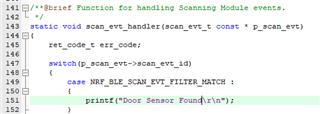

How do I implement an address filter?
I am very new to BLE development, and am building my application on top of the ble_central\ble_app_uart_c example.
I have this tag defined at the start, with the other global variable definitions.
#define NRF_BLE_SCAN_ADDR_FILTER 0x02
This is the function where I am initializing the module:
 * @brief Parameters used when scanning.
static const ble_gap_scan_params_t m_scan_params =
    .active   = 1,
    .interval = SCAN_INTERVAL,
    .window   = SCAN_WINDOW,
    .timeout  = SCAN_TIMEOUT,
    #if (NRF_SD_BLE_API_VERSION == 2)
        .selective   = 0,
        .p_whitelist = NULL,
    #if (NRF_SD_BLE_API_VERSION == 3)
        .use_whitelist = 0,
I am calling the module (or setting the filter, unsure of the terminology) here in the scan_start() function:
    .active   = 1,
        .selective   = 0,
        .use_whitelist = 0,
The scan_start() function is called in main(). I have not yet tested this implementation as it is unfinished.
My questions around this are:
  1. Where do I set the address I want to filter for? It merely advertises and I can't connect to it.
  2. Once the address is set, is this implementation correct?
Thank you!
