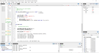

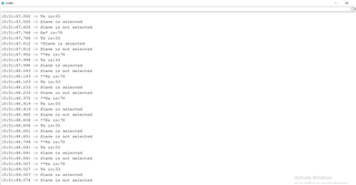

This is the second time I am posting here related issue on nrf52832 SPI communication. I am still not able to get the response from the sensor. Here I am testing my SPI is working properly or not in NRF board. so I have tested with Arduino board .What I am getting that data is transferred clearly from nrf52 to the Arduino board but when I am trying to get the data from Arduino to nrf52 it is not responding.
I am in doubt that the problem is in hardware or software. Please help me sort the problem out .
I am hereby attaching the main.c of both code for your references.
This is the Segger embedded code for nrf52.

#define SPI_INSTANCE 0 /**< SPI instance index. */
static const nrf_drv_spi_t spi = NRF_DRV_SPI_INSTANCE(SPI_INSTANCE); /**< SPI instance. */
static volatile bool spi_xfer_done; /**< Flag used to indicate that SPI instance completed the transfer. */
//#define TEST_STRING "N"
static uint8_t m_tx_buf[] = {'N'}; /**< TX buffer. */
static uint8_t m_rx_buf[2]; /**< RX buffer. */
static const uint8_t m_length = sizeof(m_tx_buf); /**< Transfer length. */
* @brief SPI user event handler.
* @param event
void spi_event_handler(nrf_drv_spi_evt_t const * p_event,
void * p_context)
spi_xfer_done = true;
NRF_LOG_INFO("Transfer completed.");
if (m_rx_buf[0] != 0)
NRF_LOG_INFO(" Received:");
NRF_LOG_HEXDUMP_INFO(m_rx_buf, strlen((const char *)m_rx_buf));
bsp_board_leds_init();
NRF_LOG_INFO("SPI example.");
spi_config.ss_pin = SPI_SS_PIN;
spi_config.miso_pin = SPI_MISO_PIN;
spi_config.mosi_pin = SPI_MOSI_PIN;
spi_config.sck_pin = SPI_SCK_PIN;
spi_config.irq_priority = APP_IRQ_PRIORITY_LOW;
spi_config.orc = 0xCC;
spi_config.frequency = NRF_DRV_SPI_FREQ_500K;
spi_config.mode = NRF_DRV_SPI_MODE_0;
spi_config.bit_order = NRF_DRV_SPI_BIT_ORDER_MSB_FIRST;
APP_ERROR_CHECK(nrf_drv_spi_init(&spi, &spi_config, spi_event_handler, NULL));
while (1)
// Reset rx buffer and transfer done flag
memset(m_rx_buf, 0, m_length);
spi_xfer_done = false;
APP_ERROR_CHECK(nrf_drv_spi_transfer(&spi, m_tx_buf, m_length, m_rx_buf, m_length));
while (!spi_xfer_done)
__WFE();
NRF_LOG_FLUSH();
bsp_board_led_invert(BSP_BOARD_LED_0);
nrf_delay_ms(200);
Here is main.c for Arduino code mentioned below.
// what to do with incoming data
volatile byte command = 0;
int select_slave = 0; //1: selected, 2: not selected
void setup (void)
Serial.begin (9600);
Serial.println ("This is SPI slave test");
// have to send on master in, *slave out*
pinMode(MISO, OUTPUT);
// turn on SPI in slave mode
SPCR |= _BV(SPE);
// turn on interrupts
SPCR |= _BV(SPIE);
} // end of setup
// SPI interrupt routine
ISR (SPI_STC_vect)
byte c = SPDR;
if(command == 0)
SPDR = 0;
else
SPDR = c;
Serial.print ("Rx is:");
delay(1000);
Serial.println (c, DEC);
Serial.print ("Tx is:");
delay(1000);
Serial.println (33, DEC);
} // end of interrupt service routine (ISR) SPI_STC_vect
void loop (void)
// if SPI not active, clear current command
if (digitalRead (SS) == HIGH)
command = 0;
if(select_slave!=2)
{ Serial.println("Slave is not selected");
select_slave = 2;}
else
command = 1;
if(select_slave!=1)
Serial.println("**Slave is selected");
Serial.println(select_slave);
select_slave = 1;
} // end of loop
