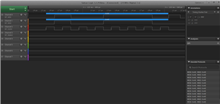

This is the second time I am posting here related issue on nrf52832 SPI communication. I am still not able to get the response from the sensor. Here I am testing my SPI is working properly or not in NRF board. so I have tested with Arduino board .What I am getting that data is transferred clearly from nrf52 to the Arduino board but when I am trying to get the data from Arduino to nrf52 it is not responding.
I am in doubt that the problem is in hardware or software. Please help me sort the problem out .
I am hereby attaching the main.c of both code for your references.
