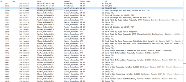

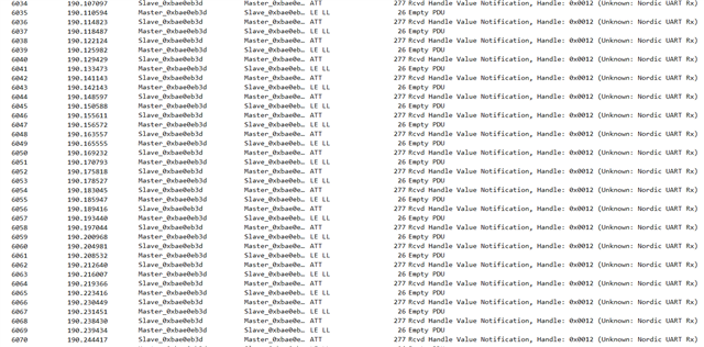

    about 3rd my said, NRF_SDH_BLE_GAP_EVENT_LENGTH == 6.  here the sniffer info.
    I am glad to see that you now have the sniffer tool up and running, great!
    Could you share the complete sniffer trace file instead of screenshots? This would be very helpful since it enables me to see 'the full picture'.
    Right now, I am unable to see how many notifications that are fit into each event, since I neither see the delta time nor connection event number column.
