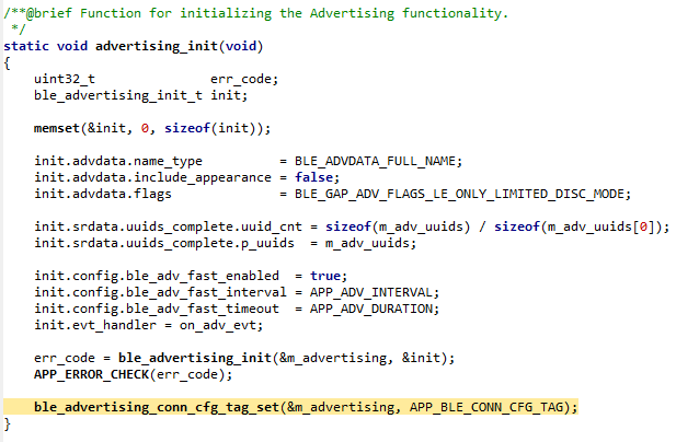

  • Hi
    When you configure the advertising payload you can set the handle, and you just need to make sure that you use two unique handle numbers that you can refer to later.
    Below is an excerpt from the ble_app_uart example, showing how the handle is set:
    In most examples the handle is just set to 1, since there is only one type of advertise packet defined.
    In your case you can just use 1 and 2.
