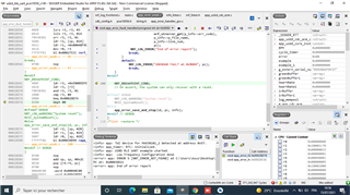

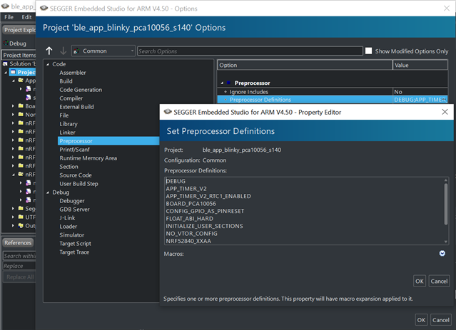

    You are only ever checking if your call to ble_nus_data_send is returning successfully - you will not be informed in the case that the call fails. Please pass the returned error code to an APP_ERROR_CHECK, and make sure to have DEBUG defined in your preprocessor defines, like shown in the included image:
    This will make the logger output a detailed error message whenever a non-NRF_SUCCESS error code is passed to an APP_ERROR_CHECK.
    Furthermore, the second argument of the ble_nus_data_send call should be a uint8_t pointer, not a uint8_t value, please change rectify this.
