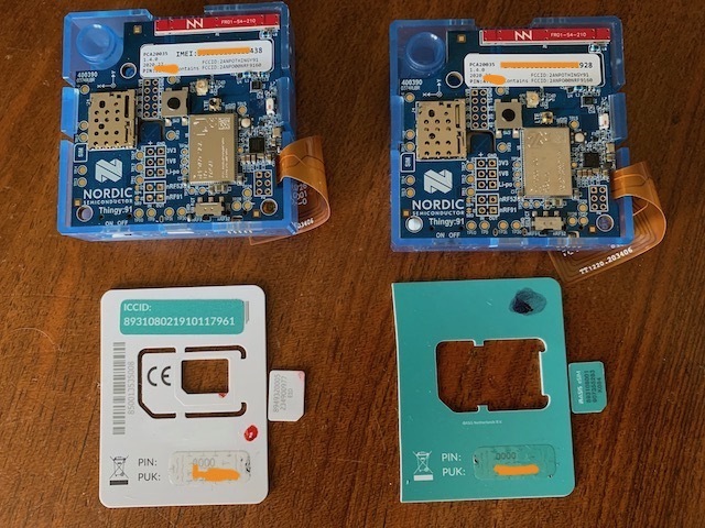

I cant seem to get the Thingy 91 into boot MCU mode, so that I can update it to the latest firmware.
No matter how many times I try turning the unit off and powering up with the larger press button held down, the firmware programming returns an error complaining that the unit is not in BootMCU mode.
Is there anything else I could try?

    Do both Thingys have the same hardware revision as well? You can check this via the white label on the PCB.

  • Thanks Markus - the revision of the non-working one is 1.4.0 2020.23 (the other one is the same but has 2020.22)
    I've installed the AT Client app and run the tests, as suggested. Please find the log file enclosed.

     Are you using the same SIM card on both devices?

    Markus
  • Thanks Markus, I used the Basis sims that came in the box with the devices. The unit that is causing problems has an aquamarine coloured SIM whilst the working unit has a white SIM. in the pic, the unit on the left is the working one.
