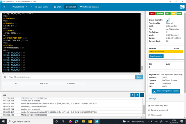

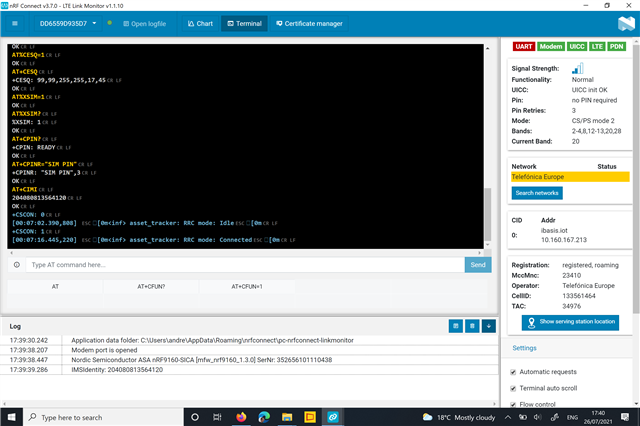

  • I did try to add my two Thingy 91 devices to nRF cloud before (before updating the firmware and loading the Asset Tracker app. One of them was successfully added - but I later deleted it.
    I did follow the test procedure and believed that I could see a connection made (and there is a pulsing blue led light on the Thingy91. However I still get the error code 40412.
    In the link monitor I see the 'LTE' indication changing between orange and red every second
    Any thoughts?
    Andrew.
  • Interestingly I tried the same process with my other Thingy91 (using the same hex file for the Asset tracker app) and I find I can get a connection and was able to register the device in the cloud, successfully.
