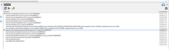

My app is based on ble_app_hrs_rscs_relay, i.e. the nRF52 DK is acting as central and peripheral at the same time.
SDK 17.0.2, SD S132 v7.
I have a service running there that I want to debug using python with "bleak" to inquiry the service.
Connecting to my service fails. As it turned out, apparently due to failed bonding.
As I don't know if it's possible to have bleak bond (didn't find anything regarding this), I deactivated bonding in my code for the tests.
Much to my surprise PM still seems to do bonding?

In my logs I still get this after connecting:
[00:00:00.052,795] <info> app: App started.
[00:00:00.066,589] <info> app: Fast advertising.
[00:00:00.556,701] <info> ble_service: ble_service::ble_service_on_ble_evt::BLE_GAP_EVT_CONNECTED
[00:00:00.557,250] <info> app: Client connected to us using us as server (peripheral)
[00:00:00.561,218] <info> peer_manager_handler: Connection security failed: role: Peripheral, conn_handle: 0x2, procedure: Encryption, error: 4102
[00:00:00.562,011] <warning> peer_manager_handler: Disconnecting conn_handle 2.
[00:00:00.562,500] <info> app: PM_CONN_SEC_PROCEDURE_ENCRYPTION  procedure failed
[00:00:00.562,927] <info> app: Error PM_CONN_SEC_ERROR_PIN_OR_KEY_MISSING
[00:00:00.563,354] <info> app: Error source = 0x0 (BLE_GAP_SEC_STATUS_SOURCE_LOCAL)
[00:00:00.563,781] <info> app: Establishing a secure link by Peer Manager failed! Trying to remove bonds and rescan
Also the stack trace when receiving the event obviously shows the code is going through the secure setup.
Any idea what could be the reason for this?
I also left out the actual call to pm_sec_params_set(&sec_param); in general as recommended but also this didn't change the behavior.
Is there any other reason why PM tries to perform the bonding? I also tried to delete the actual peer DB, but also this didn't help (of course).
  • Hi Markus,
    From what I can tell, you got this issue because the central device (PC) already has a bond with the board. When the connection is established the PC (bleak python) tried to encrypt the link with a previously bonded information. Since there is no bond information on the nRF52 it reject this request, resulting what you can see in the log.
    I would suggest to delete bond information on PC side and test again. I'm not sure where the bond information is stored or if there is actually bond information because I'm not very familiar with the bleak Python library.
    I would suggest to use a sniffer trace to verify what happened over the air.
  • Hi Hung Bui,
    this sounds reasonable, thanks! So it means, even if I say 'no security needed at all' the remote party can still say "But _I_ want to!"? That would explain it...
    I found a pairing in the Windows setting and when i removed that one, the problem got solved.
    Thank you very much!
