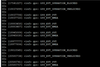

One of my projects needs to use NB and GPS functions at the same time. When testing, I found that even though NB network is not transmitting data, after I start GPS, I often receive messages that the operation is blocked. Why is that?
This is my code:

  • duxinglang said:
    but because of the SIM card, the Modem returned a connection failure, so I closed the modem, and then reset AT+CFUN=1 to turn on the modem when the GPS was needed.
    I do honestly not think that this sounds about right. What kind of connection failure does the modem return?
    duxinglang said:
    I don't think there should be any NB operation to block the GPS in this case.
    The thing is that, as long as the LTE socket is not in RRC idle, the GPS socket will not run.
    Markus
