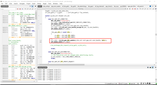

  • Ok,Besides MTU, are there any other ways to increase the rate?The device has requested to update the PHY to 2M. How can I confirm that the PHY has been successfully updated on IOS NRF connect APP?
  • Hi Helen
    Whenever the PHY is changed you should get the BLE_GAP_EVT_PHY_UPDATE event from the SoftDevice.
    Along with this event you get the following struct, which includes information about which TX and RX PHY you are currently using, and the status of the last PHY update procedure:
    /**@brief Event Structure for @ref BLE_GAP_EVT_PHY_UPDATE. */
    typedef struct
      uint8_t status;                               /**< Status of the procedure, see @ref BLE_HCI_STATUS_CODES.*/
      uint8_t tx_phy;                               /**< TX PHY for this connection, see @ref BLE_GAP_PHYS. */
      uint8_t rx_phy;                               /**< RX PHY for this connection, see @ref BLE_GAP_PHYS. */
    } ble_gap_evt_phy_update_t;
    Can you confirm what kind of throughput you are currently seeing, after taking advantage of the 182 byte packet length, 2M phy and 15ms connection interval?
