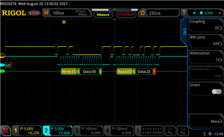

I ran an I2C scan example using I2C1 peripheral and it works fine
found 5 I2C slave address

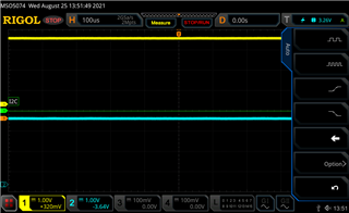

Now, I tested with I2C3 (I'm thinking of using UART1 for GSM)
so I changed the nrf5340dk_nrf5340_cpuapp.overlay file to
&i2c3 {
	sda-pin = <8>;
	scl-pin = <7>;
	status = "okay";
then I changed  i2c_dev = device_get_binding("I2C_1"); -----> i2c_dev = device_get_binding("I2C_3"); in the main.c
but it doesn't work: the I2C device driver was found but it doesn't find any I2C slave address
