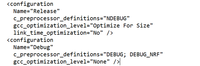

    I understand. Could it be that you have only made changes to your debug build configuration during the development, instead of making them for the common configuration?
    Could you show me the difference between the release and the debug configuration? You can see this in plain text if you open your SES project file in an editor, instead of opening it with SES.
    It may look something like this:
      <configuration
        Name="Release"
        c_preprocessor_definitions="NDEBUG"
        gcc_optimization_level="Optimize For Size"
        link_time_optimization="No" />
      <configuration
        Name="Debug"
        c_preprocessor_definitions="DEBUG; DEBUG_NRF"
        gcc_optimization_level="None" />
    Karl
  • Is this what you wanted me to check? It's same as yours. Is it correct?
  • Yes. Could you try changing the gcc_optimization_level for release to "None", to see if this makes your Release build configuration behave the same as your debug configuration?
    Have you made any other changes to the project options's tab for the debug configuration, compared to the common or release configuration?
    Karl
  • Changed it to "None". It works just like Debug configuration.
    No. I didn't make any other changes.
