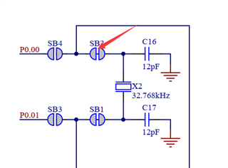

nrf52833 P0.0 will output high level strangely
SDK17.0.2+NRF52833
I use nrf52833 to do some thing, P1.09 and p0.11 as two pwm singals to drive two motor and P0.0 as a led pin (high made led light).
the code as following:

I want light the LED after pwm init. but the led(connected P0.0)lighted before my code to output the p0.0 high level-when the pwm0_init function executed. It's not match my desire.
additional: Softdevice burninged(s140_nrf52_7.2.0_softdevice.hex)
  • Hi
    It should work as intended with Keil µVision as well, and you should be able to use your preferred IDE for development. Does the project compile and flash successfully with Keil µVision? Are you sure that the application is flashed with the SoftDevice correctly when using Keil? I see no reason why Keil wouldn't work while SES does.
    Simon
  • All of my operations are correct, the strang thing exist, so it confused me. You can use PCA10100 demo board to do a test. (I disconnect the 32k xtal with p0.0.)
  •  cut off SB1 and SB2 here. You can make a try use keil add my code above, run the program and to test P0.0 level when executed function nrf_drv_pwm_simple_playback(&m_pwm0, &m_pwm_seq, 1, NRF_DRV_PWM_FLAG_LOOP).
  • Please note that you also have to short SB3 and SB4 to get an output to P0.00 (and P0.01) as well.
    For me to test your application, can you upload the entire main.c file (or just the .hex file you have) so I can test the same application you have on a DK on my end.
    Simon

  • OK,it's solved! NRF_DRV_PWM_PIN_NOT_USED was missed out.@, thank you very much!
  • Glad you got to the bottom of this issue. Great detective work!
