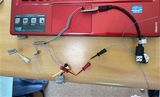

I'm trying to make very simple iBeacon. So, I modified an example of  'ble_app_beacon'.
Things what I have done are below

And my nRF52832 module is MDBT42Q which manufactured by Raytec.
It is extremely simple just like a pic below. (To write programs and so on, I've done with J-LINK EDU MINI.)
Is there anybody have made some thing like this???

  • 1. wrote J-Link OB-SAM3U128-V2-NordicSemi 170724.bin to nRF52832 module via 'J-Flash Lite V6.88a'.
     This is the FW for the onboard JLink on the nRF5 DK, and should not/can't be flashed to the nRF52832.
    The connections from the JLink to the module should be SWDIO, SWDCLK, Vref and GND. Then you should be able to flash the beacon FW.
    Not sure if you are seeing any issues, or if your application runs fine, based on the description.
