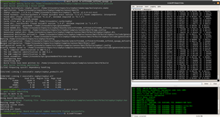

I am attempting to get the BMI270 sample working on an nRF5340DK, using nRF Connect SDK v1.6.0, but all attempts at device_get_binding("BMI270"), device_get_binding(DT_LABEL(DT_INST(0, bosch_bmi270))), and similar return null.  I am using the following config and overlay files

gives the output
00> *** Booting Zephyr OS build v2.6.0-rc1-ncs1  ***
00> Could not get BMI270 device
in J-Link RTT Viewer.

    After digging a little and reading through Marti's comments here I finally tracked down the problem. This issue arises because of how the TWI with easyDMA hardware is implemented on the nRF5340. You can read more about it in this GitHub issue.
    In summary burst writes from the nRF5340 generates repeated starts, which are not handled well by some sensors/devices. Seemingly BMI270 is one of these. The fix for this issue is to use the normal i2c_write() function instead of i2c_burst_write(). If you choose to change the driver to work with the nRF5340, please consider doing a PR for the fix for the Zephyr RTOS GitHub repository as well. EDIT: try the method presented in my comment below instead.
    You do not see this issue on the nRF52833 as it by default is using TWI without easyDMA.
    Thank you for your patience and thank you Marti for the help. It was the following comment that helped me pick up the scent:
    marti.bolivar.nordic said:
    From your screenshot, you're getting -EIO from the i2c_burst_write() call on line 35, which indicates a real error coming out of i2c_nrfx_twim_transfer() in the I2C driver, i2c_nrfx_twim.c.
