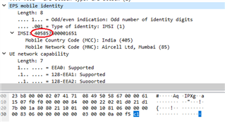

  • Hi! Håkon has gone on vacation so I have taken over this case.
    The conclusion from the modem trace you provided is that the Attach procedure is prevented due to the modem reset loop restriction feature which was introduced in MFW 1.3.0. We have just released a white paper on the feature which should explain the functionality in detail: nWP042 - nRF9160 Modem Reset Loop Restriction
    In short, the feature restricts Attach attempts to the network for 30 minutes in the case where the modem detects that the UE is in a reset loop. This can also happen if the modem is manually reset too many times.
    The AT+CFUN = 0 command should be used for shutting down the modem gracefully in order to avoid this restriction.
    Please let me know if this solves the issue you are seeing.
    Heidi

  • 1. Yes, the problem isn't the reset loop but the logs aren't showing why the Attach isn't succeeding, because the Attach request is being blocked by the reset loop. So we needed a trace where the reset loop isn't blocking the Attach request to be able to see the reason for failure, which is most likely the same reason on MFW 1.2.3.
    I thought reset loop only present in MFW  1.3.0 and not in MFW  1.2.3, so I assumed there will be no reset loop blocking in MFW 1.2.3.
    Your log revealed why the Attach doesn't succeed. The network does not allow to access with this SIM card (no matter which MFW version used), because there is no roaming agreement etc. If it should be possible to access the network with this card, you need to contact the carrier to resolve this.
    I already contacted them, earlier they are asking for more detailed log Like I said in earlier posts. Let me send them new log, but they are asking for LTE Physical, MAC, RRC, NAS signaling so don't know they can support.
    So in the both new logs there is no reset loop observed. Right?
  • There is no roaming as they are the only cellular provider in India at the moment for NBIOT, and they have PAN India NBIoT working.
     Yes, the reset loop is only present in MFW 1.3.0. The reset loop isn't the problem, but it was preventing us from seeing the reason for the ATTACH request being rejected.
    RRC and NAS is visible in the PCAP file that you have attached earlier. And they show the reject PDU from the network.
    We don't understand why they want LTE physical or MAC. The reject is clear and visible, and the failure is in the NAS level, not below, meaning RRC PDUs should not be needed either.
