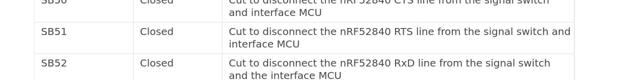

I'm trying to use P0.05 (AIN3) as output, but it does not work.
in file .dts is used as:
rts-pin = <5>;
status = "okay";
of uart0, I have to change this config?
This is my code for putting pin 5 HIGH:
#define LATCH 5
#define ON 1
gpio_pin_configure(dev, LATCH, GPIO_OUTPUT);
gpio_pin_set_raw(dev, LATCH, ON);
All other pins (for example 29, 13,  24, 9, 16) works well. Do you have some suggestion for me?
