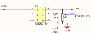

    The batterie charger is :
    I have found a current injection on a pin "LED" connected directly to nrf52810.
    When bootloader software is present -> sometime  fix at adresse 0x18808
    When bootloader software is not in flash -> sometime  firmwre restart
    Now I make multiple tests with nRF52810 pin forced to ouput whith high current configuration...
    Gaétan

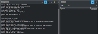

    Last log is : <info> app: Data len is set to 0xB6(182)

    Yes, without charger, we have the issue when I try to connect with NUS (nRFToolBox)
    Please found the log on device:
    I have no tested with NUS example because if DFU service is not initialized ->all is OK !
