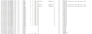

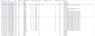

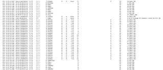

It's been a struggle to capture this behavior while sniffing packets with the NRF dongle (since we're still not sure exactly how to reproduce this issue) but we've finally been able to do it. sadly though the wireshark logs didn't make the reason for this behavior directly evident to me.
Here are some snippets of what the sniffer sees during one of these episodes, as well as the full wireshark log for deeper investigation.

  • Hi Nikolozka,
    I don't think over queueing the notification can cause such issue. The softdevice will just ignore (return NRF_ERROR_RESOURCES) then the queue is full.
    From the sniffer trace it didn't suggest that the softdevice was under much stress.
    I can see that the Slave sometimes stopped responding for a few packets, I assume it's the Slave Latency setting you chose ?
    Have you tried to debug the peripheral and check does it has any assertion  ? Or check what's the disconnection reason is when it disconnected (BLE_GAP_EVT_DISCONNECTED) ? I suspect that it got assertion and reset for some reason.
    Have you tried to test the same application on a nRF52 DK ? (so that we can rule out any issue with the hardware) ?

  • Hi Niko,
    Disconnection reason 0x08 would suggest that it could be an issue with the oscillator or the radio hardware. What I can think of is that the peripheral gradually goes out of sync or the radio hardware doesn't work as it should.
    What you can do to test is:
    1. Try testing a very simple application on the same board. ble_app_hrs for example and let it run and check if disconnection happens or not.
    2. Try testing your firmware on a nRF52DK , to verify if it's an hardware issue or not.
    Which central device are you using ? Have you tried to test the board with different central for comparison ?

  • Please do the test and let us know the result.
    From what I can tell from the log and from the disconnected reason, it suggesting that there could be RF noise or bad radio performance or out of sync oscillator would cause the issue.
