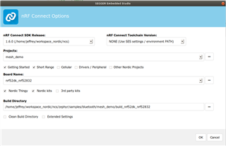

Hello, I followed getting starting guide, and got SDK and tools installed for nRF52-DK, I'm trying to open, build and run some examples. But when trying to open any example in SEGGER, I'm getting error:
Creating solution light_bulb.emProject
cmake -GNinja -DBOARD=nrf52dk_nrf52832 -DBOARD_DIR=/home/jeffrey/workspace_nordic/ncs/zephyr/boards/arm/nrf52dk_nrf52832 -B/home/jeffrey/workspace_nordic/ncs/nrf/samples/zigbee/light_bulb/build_nrf52dk_nrf52832 -S/home/jeffrey/workspace_nordic/ncs/nrf/samples/zigbee/light_bulb -DZEPHYR_TOOLCHAIN_VARIANT=gnuarmemb -DGNUARMEMB_TOOLCHAIN_PATH=/opt/gnuarmemb -DEXTRA_KCONFIG_TARGETS=menuconfig_ses -DEXTRA_KCONFIG_TARGET_COMMAND_FOR_menuconfig_ses=/home/jeffrey/Tools/arm_segger_embedded_studio_v550d_linux_x64_nordic/html/configure_nordic_project_menuconfig.py

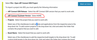

  • Hi Max
    Thank you for the updated information. Indeed, NONE is the correct toolchain version to use when you follow the Getting Started guide, my mistake (I'm used to the Toolchain manager for Windows). It seems your issue is that the West version you're using is rather outdated. Try upgrading it with the pip install west -- upgrade call to get the most recent version. If that doesn't help, please try moving the path to NCS one or two steps down.
