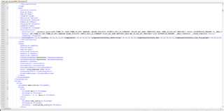

Hi, the project file (.uvprojx) is a standard XML file, so you should be able to copy the corresponding tags (<IncludePath>) from one file to another.
Hi Stian,
Which part I can copy and paste for merging two different projects ?
Kind Regards,
You can try to copy the <IncludePath> tag to the new project file. I believe <IncludePath> should be at least two different places in that file.
