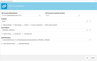

I just open the example and build.
There's an error, but I can't fix it.
I didn't touch the any file.
Why did this happen to me?
To use the lpuart driver, you must enable it in Kconfig and device tree. This is done for several boards in the lpuart sample, but not for the non-secure nRF91 DK.
But, if you rename the nrf9160dk_nrf9160 files in the boards folder of the sample to nrf9160dk_nrf9160ns, it should work.
Didrik
Thanks for reply. Your reply removed my err.
