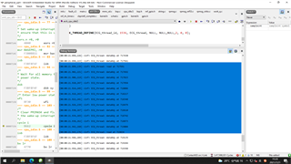

but every 4ms can enter interrupt,but need 30ms read a time data:
the debug log out information :always 4ms enter interupt a time ,but 30ms read data a time ,so most of ecg data are not read and  lost.
   time interval but each "dataRdy at "almost 131 ,every 32768 mean one second, so  131/32768=0.004s . but enter many time interrupt,in ecg thread take one time semophere and only read one time . "read at %" and "dataRdy at " log out not same step mean enter many times interrupt and read a few time data.

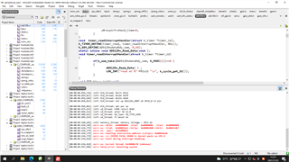

why a little code or function placed in a k_timer cb(2ms period) interrupt or placed in GPIOE interrupt   can lead zephyr os reset? zephyr os reset in below shortcut imagine happen is i place function
ADS129x_Read_Data( )  in void timer_readInterruptHandler(struct k_timer *timer_id)
