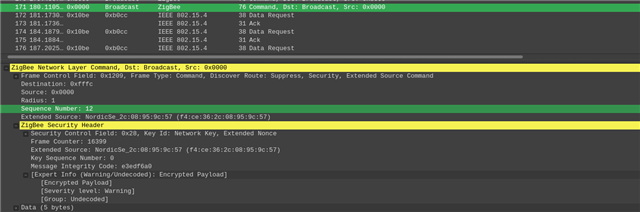

nRF Sniffer for zigbee using nRF52840 can't decrypt zigbee frame correctly
Hi everyone,
I'm using a PCA10056 board (nRF52840) to sniffer zigbee DPU, and using another 3 PCA10056 board excute the zigbee-light_control example. I already configured sniffer environment follow https://infocenter.nordicsemi.com/index.jsp?topic=%2Fsdk_tz_v4.0.0%2Fnrf802154_sniffer.html and received zigbee DPU in wireshark successfully.
But the weird thing is that zigbee frame cannot be decrypt correctly as follows although I already added the zigbee protocol Pre-configure key. Did I forget some steps?
Thank you for your help.
Zhoushuai
