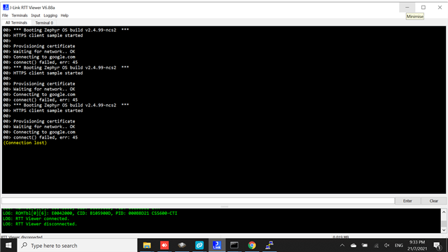

HTTPS client connect fails with Error 45 with 1nce sim card in France
I used 3HK sim card on NB-IoT in Hong Kong, and I could run GET and POST instructions to any cloud with the right certificate.
Recently, I moved to France, and I switched to 1nce MVNO and now the connection fails with error 45. The certificate hasn't changed.
We also tried to connect to google, using google certificate. That also fails. TLS socket setup with TLS_HOSTNAME option with host google.com didn't help either.
ncs 1.5.1
modem fw 1.2.3
Attached is the build files and the modem trace.
Could you help on this urgent matter, please?

  • Hi Heidi,
    The modem_key_mgmt_cmp() used in the firmware returns 0 even though the certificate associated with the TAG doesn't exist in the modem which prevents the fw logic to write the certificate onto modem and use it.
  • Do you mean modem_key_mgmt_exists() like on line 70?
    This function will return 0 if the operation of checking is successful. And then the function parameter exists to see if the credential exists in persistent storage.
    If you meant modem_key_mgmt_cmp(), please provide a code snippet to show how you are calling it.

  • Hi again,
    I'm not able to connect to example.com with the certificate located in the application you provided either. However, when using the certificate located in https_client NCS v1.5.1 called "DigiCertGlobalRootCA.pem", I am able to connect, so could you try that?
    To debug the modem_key_mgmt_cmp issue, please add the following code snippet after line 19 (printk mismatch, match) and show me the output. I'm not able to reproduce it, the function fails when the certificate doesn't exist in the modem.
    enum at_cmd_state state = AT_CMD_OK;
    char at_response[CONFIG_AT_CMD_RESPONSE_MAX_LEN];
    at_cmd_write(MODEM_KEY_MGMT_OP_LS, at_response, len, &state);
    printk("Result from %s is %s\n", MODEM_KEY_MGMT_OP_LS, at_response);
    if (state != AT_CMD_OK) {
    	printk("Error from at_cmd_write: %d\n", state);
    1) How do the modem_key_mgmt_exists and modem_key_mgmt_cmp API perform?
    You can take a look at the implementation in modem_key_mgmt.c
    Regarding question 2 and 3, I can ask the developer why they chose to implement it like this. But, yes, if you just make sure to provision the certificate every time it might help the issue. However, try with the correct certificate first.
