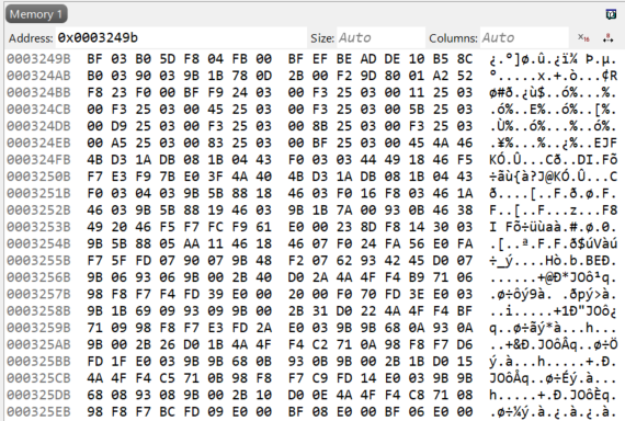

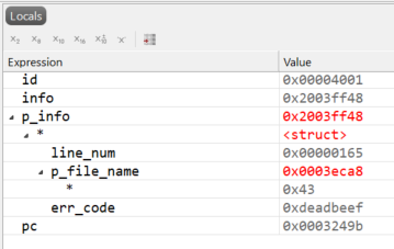

when the code enable the softdevice, I'm redirected to app_error_fault_handler. You can see below id's error and p_info who tell me that err_code equal to 0xdeadbeef
Sometime I get 0x165 for the line_num.

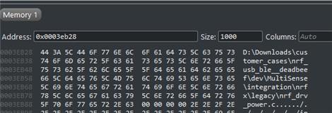

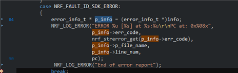

  • This is an SDK error
    And looking at the p_info structure, it gives the file name and line number
    looking at nrf_drv_power.c line 0x165 which is deciman 357

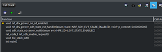

    It looks to me that this function is called without the nrf_drv_power being initialized. Setting a breakpoint here and running again shows the call stack
    The nrf_drv_power_init is called in app_usbd_init which is called in your usbd_thread. But this thread does not start until the scheduler starts later on.
    Cleaner way would be just call this below before ble_stack_init
    #if APP_USBD_CONFIG_POWER_EVENTS_PROCESS
        uint32_t ret = nrf_drv_power_init(NULL);
        if ((ret != NRF_SUCCESS) && (ret != NRF_ERROR_MODULE_ALREADY_INITIALIZED))
            /* This should never happen */
            APP_ERROR_HANDLER(ret);

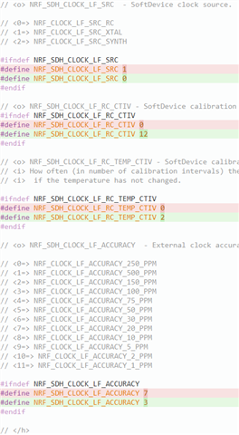

     This is strange, but possible to happen if you have given the clock configuration wrong?
    It looks like you have set the NRF_SDH_CLOCK_LF_SRC in the sdk_config.h to XTAL. The softdevice might stall waiting for the XTAL to start if there is no XTAL or if your XTAL is not starting up as it should. Please check if this setting is right for you?
  • Thanks again!
    That's exactly it, I don't have an XTAL so changing the configuration to use RC makes everything work.
