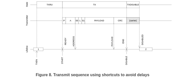

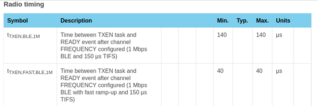

Radio 2.4 Ghz, Enable Fast mode in Rx and Tx
How to enable fast mode for radio transmission and reception (I am using nRF5 SDK). These are the default examples and I can see that fast mode is not implemented:

Transmission:
 void send_packet(uint32_t* packet)
    // Set payload pointer
    NRF_RADIO->PACKETPTR = (uint32_t)packet;
    // send the packet:
    NRF_RADIO->EVENTS_READY = 0U;
    NRF_RADIO->TASKS_TXEN   = 1;
    // NRF_LOG_INFO("Waiting for ready");
    while (NRF_RADIO->EVENTS_READY == 0U)
        // wait
    NRF_RADIO->EVENTS_END  = 0U;
    NRF_RADIO->TASKS_START = 1U;
    // NRF_LOG_INFO("Prepare sending");
    while (NRF_RADIO->EVENTS_END == 0U)
        // wait
    // NRF_LOG_INFO("Done sending");
    err_code = bsp_indication_set(BSP_INDICATE_SENT_OK);
    // NRF_LOG_INFO("The packet was sent");
    NRF_RADIO->EVENTS_DISABLED = 0U;
    // Disable radio
    NRF_RADIO->TASKS_DISABLE = 1U;
    while (NRF_RADIO->EVENTS_DISABLED == 0U)
        // wait
Would really appreciate some help.
