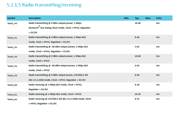

    10mA on the Light switch server is also correct. A normal mesh node (not LPN) is designed to do radio scanning all the time. It doesn't really matter if it's a friend node or not. The significant part of the consumption is radio scanning.
    At chapter 5 in the nRF52840 datasheet you can find the current consumptions:
    I'm not sure if you are using DCDC or not, but the number matched with radio receiving with no DCDC.
    If you use DCDC the consumption can be lowered down to 6.53mA.
    Bluetooth Mesh is not designed as a low power mesh. So I am not sure there could be an easy way to reduce the power consumption of the Friend nodes without affecting the performance of the mesh network. A connected mesh protocol (instead of flooding mesh) may have lower power consumption on the backbone nodes but it's more complex and has some drawback as well (for example dynamically and mobility)
