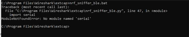

  • I am having problems with a release build, and cannot get a debug log from the device while the DFU is happening. I am having trouble installing the Wireshark Sniffer extension. I have attached a capture of the error message. I have tried using NRF Toolbox to do the DFU, and that fails as well.
  • If you have pip installed, you can install serial from the command line with:
    pip install pyserial
