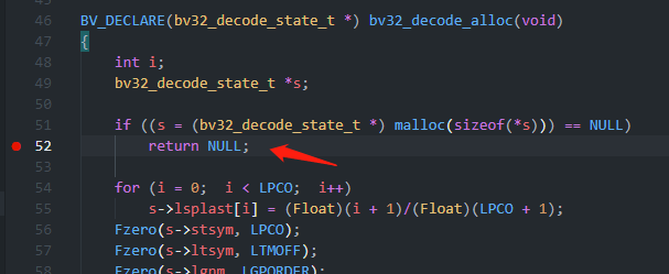

I have a BLE device with a MIC, which collects voice data and coded to BroadVoice 32k.
So I want to design a central to get this voice data.
What I think is use 52840 and external I2S decoder to do it.
I have some concerns:
1.Is there any example how to play broadvoice codec with 52840?
2.Does 52840 have enough capability to do the decode thing?
Thanks.

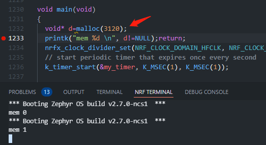

    Good to hear that enabling newlib fixed your issue Slight smile
    Please note that in NCS you should use k_malloc() instead of malloc(), sorry for not specifying this earlier.
