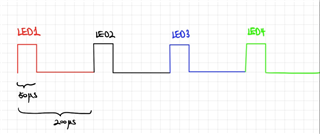

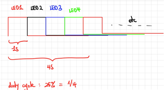

    I'm sorry to disturb you again.
    I want to make the four external leds have the same period and same dutu cycle which equal 25%. It means that these four leds should to be on one after another, the previous one will go out when the next one is on.
    I tried to write such code:

    #define PERIOD_USEC	(USEC_PER_SEC/5U)
    #define PULSE_WIDTH	(PERIOD_USEC/4U)
    enum { LEDEXT1, LEDEXT2, LEDEXT3, LEDEXT4 };
    void main(void)
    	const struct device *pwm_dev[4];
            int ret1, ret2, ret3, ret4;
    	printk("PWM-based blinky\n");
            pwm_dev[LEDEXT1] = device_get_binding(PWM_LABELEXT1);
            pwm_dev[LEDEXT2] = device_get_binding(PWM_LABELEXT2);
            pwm_dev[LEDEXT3] = device_get_binding(PWM_LABELEXT3);
            pwm_dev[LEDEXT4] = device_get_binding(PWM_LABELEXT4);
            if (!pwm_dev[LEDEXT1] || !pwm_dev[LEDEXT2] || !pwm_dev[LEDEXT3] || !pwm_dev[LEDEXT4] ) {
                    printk("Error: cannot find one or more PWM devices\n");
    		return;
            printk("Calibrating for device %s channel %d...\n", PWM_LABELEXT1, PWM_CHANNELEXT1);
            printk("Calibrating for device %s channel %d...\n", PWM_LABELEXT2, PWM_CHANNELEXT2);
            printk("Calibrating for device %s channel %d...\n", PWM_LABELEXT3, PWM_CHANNELEXT3);
            printk("Calibrating for device %s channel %d...\n", PWM_LABELEXT4, PWM_CHANNELEXT4);
    	while (1) {
                    ret1 = pwm_pin_set_usec(pwm_dev[LEDEXT1], PWM_CHANNELEXT1, PERIOD_USEC, PULSE_WIDTH, PWM_FLAGSEXT1);
                    if (ret1 != 0) {
                            printk("Error %d: led externe 1 write failed\n", ret1);
                            return;
                    k_sleep(K_MSEC(50));
                    ret1 = pwm_pin_set_usec(pwm_dev[LEDEXT1], PWM_CHANNELEXT1, PERIOD_USEC, 0, PWM_FLAGSEXT1);
                    if (ret1 != 0) {
                            return;
                    ret2 = pwm_pin_set_usec(pwm_dev[LEDEXT2], PWM_CHANNELEXT2, PERIOD_USEC, PULSE_WIDTH, PWM_FLAGSEXT2);
                    if (ret2 != 0) {
                            printk("Error %d: led externe 2 write failed\n", ret2);
                            return;
                    ret2 = pwm_pin_set_usec(pwm_dev[LEDEXT2], PWM_CHANNELEXT2, PERIOD_USEC, 0, PWM_FLAGSEXT2);
                    if (ret2 != 0) {
                            return;
                    ret3 = pwm_pin_set_usec(pwm_dev[LEDEXT3], PWM_CHANNELEXT3, PERIOD_USEC, PULSE_WIDTH, PWM_FLAGSEXT3);
                    if (ret3 != 0) {
                            printk("Error %d: led externe 3 write failed\n", ret3);
                            return;
                    ret3 = pwm_pin_set_usec(pwm_dev[LEDEXT3], PWM_CHANNELEXT3, PERIOD_USEC, 0, PWM_FLAGSEXT3);
                    if (ret3 != 0) {
                            return;
                    ret4 = pwm_pin_set_usec(pwm_dev[LEDEXT4], PWM_CHANNELEXT4, PERIOD_USEC, PULSE_WIDTH, PWM_FLAGSEXT4);
                    if (ret4 != 0) {
                            printk("Error %d: led externe 4 write failed\n", ret4);
                            return;
                    ret4 = pwm_pin_set_usec(pwm_dev[LEDEXT4], PWM_CHANNELEXT4, PERIOD_USEC, 0, PWM_FLAGSEXT4);

    But I didn’t get the result I wanted. The picture below  show the result that I obtened.
    But what I want is the following picture:
    Do you have any idea?
    thank you in advanced!
  • Hi again,
    Try using PWM sequences for this. They will let you set up how the PWM should behave over multiple periods, and have different behavior for each channel and for each period, all on a single PWM. You can for example, using a 250ms period, set PWM0, ch0 (LED1) to 4 periods at 100%, followed by 12 periods at 0%, and PWM0, ch1 (LED2) to 4 periods at 0%, 4 periods at 100%, 8 periods at 0% etc.
    I believe the functions in these two files will be useful:
    https://github.com/nrfconnect/sdk-hal_nordic/blob/master/nrfx/drivers/include/nrfx_pwm.h
    https://github.com/nrfconnect/sdk-hal_nordic/blob/master/nrfx/drivers/src/nrfx_pwm.c
    I am looking into the easiest way to access this functionality now, and I will get back to you.
  • I have ported a demo from the nRF5 SDK to NCS v1.4.2, and modified it to the behavior you are looking for.
    4130.blinky_pwm_test.zip
    You can probably clean it up a lot, but it seems to work.
