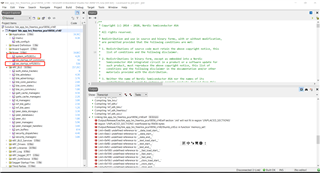

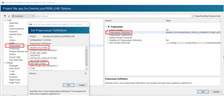

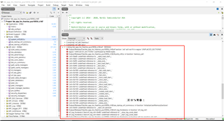

The following error occurred after I followed your steps.
The pictures below are my configurations.
