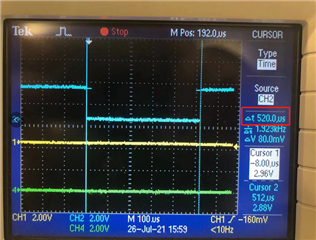

i have ESB project for customer, and now i have one fundamental question about RTC cc compare event, i am struggled in this problem.
static __INLINE void radio_rtc_compare0_set(uint32_t value)
    RADIO_RTC->CC[0] = value -1;
I set the value as 16, so the frequent would be 16/32768 == 488us, and it is true, most case, the event happens in about 488us,
But sometime it would be 520us(just power down and power up the device), I could not figure out the reason for this.
The consequence for this is that, the frequent for the VR gaming handles would not correct (1/2*520 ==960 HZ).
After the device reset, the frequent changed, so it is not correct. It happens 20% of the chance after resetting.
The debug pin singal is simple "nrf_gpio_pin_toggle(DATA_SENDING_P1)"  from RADIO_RTC_IRQHandler(void)
any idea or suggestion on this? it would be very helpful.

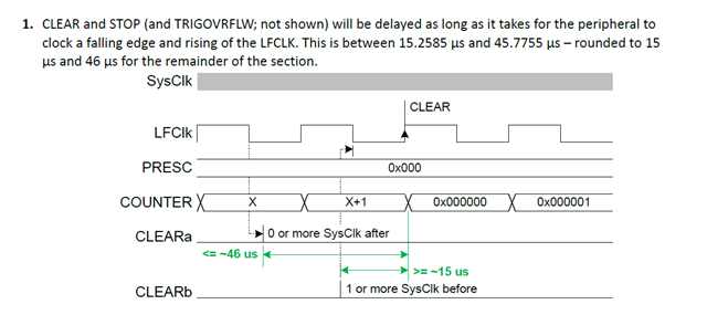

  • Hi Jørgen,
    is it related to such document in the spec? i am not sure because of this
    William.

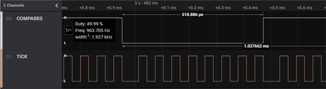

  • Hi William,
    Yes, it looks like that is correct. I created a sample application that will use PPI+GPIOTE to toggle GPIOs on the TICK and COMPARE0 events from the RTC. The COMPARE0 event will also clear the RTC through a PPI fork.
    As you can see from the logic trance, there is a delay between the COMPARE0 event where the RTC is cleared before the first TICK event occurs. This is what is described in the image you posted.
    Jørgen
