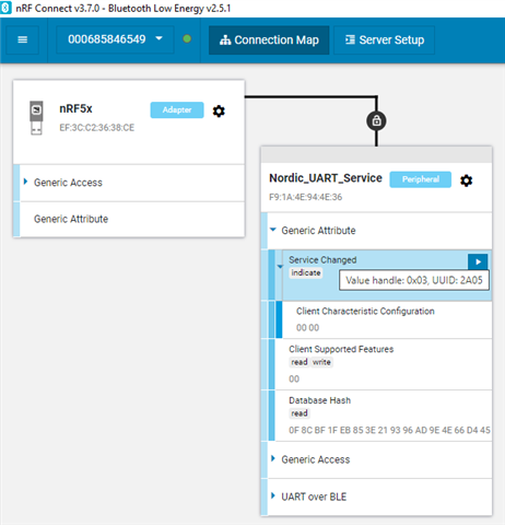

  • Can you connect using the nRF Connect for desktop : Bluetooth Low Energy app, then we can see which entry in the peer GATT table is handle 0x0003, this may be helpful in understanding what is occuring.

  • You need to "hover" over the different characteristics to find which is handle 0x0003, for instance for a random BLE peripheral I could find:
    The service changed characteristic (handle 0x0003) is indicate only, and is not writeable.
    Kenneth

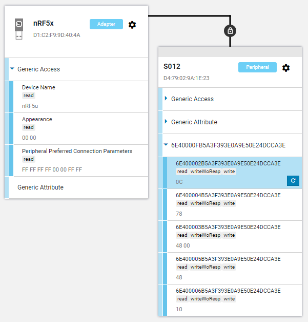

  • Ok so handle 0x0003 is asigned to Device Name in Generic Access service. My custom characteristics are as follow: 0x000D, 0x000F, 0x0011, 0x0013, 0x0015.
  • And you can write to them from the nRF Connect app? They are writeable?
    Kenneth
