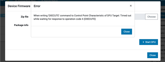

Hi Nordic,
I've implemented an extension of the NRF DFU protocol using the "external-app" type. The transfer is stored in external flash, and can be approx 1MB in size. After the transfer takes place, the image is applied to an external MCU which takes quite a bit of time during the "execute" phase of the DFU mechanism.
NRF connect for desktop times out with the error shown after approx 15-20 seconds. Meanwhile, NRF connect for iOS allows this operation to extend well over 60 seconds.
Is it possible to configure or extend this timeout in NRF connect for desktop?
