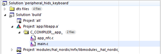

  • Hi
    Since last time we spoke we have releaset the Visual Studio Code extension for development in the nRFConnect SDK (NCS). So if you're finding SES for NCS hard to get used to, I would recommend moving to Visual Studio Code, which I personally find a lot easier to use.
    When opening an NCS project in SES the project will indeed be called libapp.a, so nothing strange there.
    The nRF52805 is indeed very limited in terms of memory, and the error you get seem to be due to the application not fitting onto the RAM. You can try removing unnecessary parts of your application, as I'd imagine you only have a very specific use in mind?
    You can also try using the nRF5 SDK which in general uses less memory, since it does not have to fit an RTOS onto the SoC. A slim example with the S112 SoftDevice for example should be able to fit I think.
    If not you will indeed have to move to a SoC with more memory.

  • Hi Cat
    You can still use SEGGER Embedded Studios, but the Visual Studio Code extension is made specifically for NCS. In the nRF5 SDK, we also have support for IAR, Keil µVision 5, and GCC if you prefer either of those.
