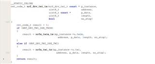

First I am getting Chip id correctly using twi communication. After that for IMU initialization , I need to send (transmit) 8192 bytes BMI270 config file without any stop bit(burst write only). For TWI transmit I am using "nrf_drv_twi_tx"  function which has only 255 bytes data length limit as shown below.
So question is how to transmit more than 255 bytes buffer at time ? Can I change data length in the function and send data using same nrf_drv drivers? If yes then what changes I have to do in library ?
