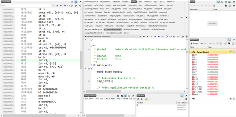

Yes It gets stuck to unknown address. I need to restart the device in order to make it connectable.
Please post a screenshot showing the CPU register and dissambly view in your IDE when the program is stuck at this unknown address.
I see log messages in the debug terminal, so I suppose you have NRF_LOG_ENABLED set to '1' now? Anyway. The CPU registers shows that hardfault exception has been raised in your program. You can try to use our HardFault handling library to help find out what's really causing it.
