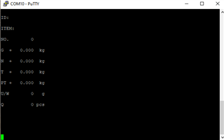

I connect an external device to my nRF52840 DK via UARTE and I receive the data properly via PuTTY.
I want to transmit the data via BLE. So I implement ble_app_uart example in nRF5_SDK_17.0.2, but I can't receive the data properly.
The size of the data is less than 255 bytes.
here the data that I received via PuTTY :

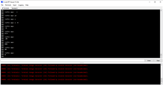

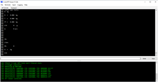

and this is my problem:
the picture of the data that's received via BLE.
Note: I have the same problem with nRF Connect App, too.

  • Hi Reza,
    Please try to debug and check the data array you receive via UART.
    Note that the data we transmit either via BLE or UART is an array of bytes. Try to avoid comparing the ASCII representation as it may differ due to different way of display text.
    Try to catch (as data array not ASCII) what you receive on the nRF52 from UART, then what you receive on the Phone.
