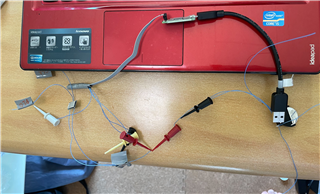

    Sorry about the confusion that I made.
    I meant 'softdevice'.
    I've wondered if I need to modify or custom 's132_nrf52_7.2.0_softdevice.hex'.
    BTW, VDD on my custom DK is about 3V as I supply power by CR2032 buttery.
    Kindly Regards,
    Shigeto
