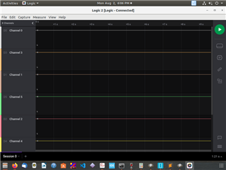

    Hardware Setup:
    The nRF52840 Dk board is connected with USB cable on port micro USB port (not nRF uSB). The nRF Power source is selected to VDD. And SW6 is selected to nRF only.
    LogiC Analyzer:
    I am not seeing any movement on Clock pin and CS pin as well in Logic analyzer.
    What could be the possible issue ? What step i can do next ?
