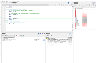

I have tested FOTA code in nRF52840 DK and it works perfect but i have custom board build with nrf52840 when i implement the code it doesn't get start
custom board not have 32.768khz crystal

Yes i have done it but no response

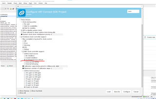

For above also no config changes still the clock doesn't changes
can you once again check my steps

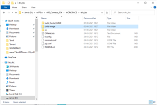

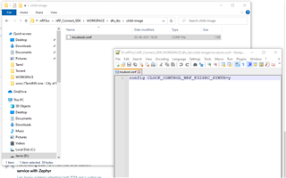

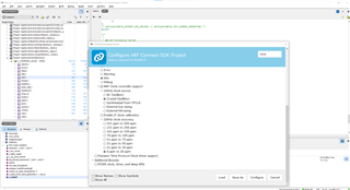

1. My project dfu_lbs created . inside dfu_lbs created folder called child_image
2. in prj.conf added
# Clock configuration
CONFIG_CLOCK_CONTROL_NRF_K32SRC_SYNTH=y
3..Inside child_image created mcuboot.conf and pasted
CONFIG_CLOCK_CONTROL_NRF_CALIBRATION_MAX_SKIP=0
CONFIG_CLOCK_CONTROL_NRF_CALIBRATION_TEMP_DIFF=0

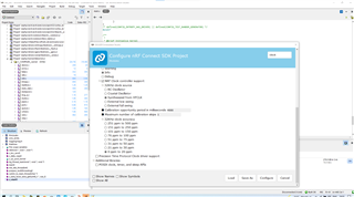

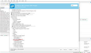

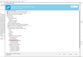

opened the project and cross verified with
project -> configure nrf connect sdk project
a. menuconfig
b. mcuboot_menuconfig
clock doesn't changed in mcuboot.
I am using SDK v1.4.2 does any thing need to change

Sunil vignesh said:I am using SDK v1.4.2 does any thing need to change
This ncs version does not automatically load child_image configuration, so you need to add this just below the cmake_minimum_required() line in CMakeLists.txt:
list(APPEND mcuboot_OVERLAY_CONFIG
"${CMAKE_CURRENT_SOURCE_DIR}/child_image/mcuboot.conf"

Please add it just below the cmake_minimum_required() line.
Yes, It works,
Thanks Håkon.

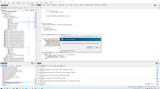

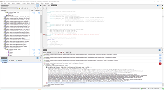

I have enabled DFU in project after that function "Go to definition"
is not working
