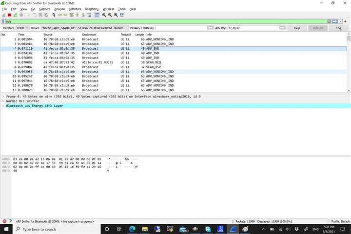

    To find what may be reducing the throughput further we may need an on-air sniffer log:
    https://infocenter.nordicsemi.com/topic/ug_sniffer_ble/UG/sniffer_ble/intro.html

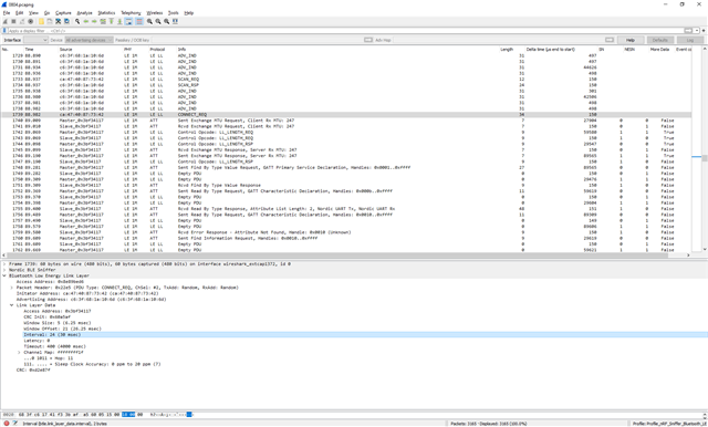

  • I suggest to check out the throughput example project in the nRF5 SDK. For instance your connection interval is rather slow (30ms), it should be possible to lower this to for instance 7.5ms if you have an nRF device in both ends of the link:
    Another strange thing is that I can see the master is skippin many connection intervals, it should be consistenly 30ms, but instead I can find it's both ~30, ~60, and ~90ms intervals. Likely this indicate that the central is busy scheduling other BLE activities, either other links, scanning etc. So this will have e negative effect on the throughput for the link you are monitoring.
    Not quite sure what you can tell me about the other BLE activities the central is doing here, but that seems to be the main limiting factor.

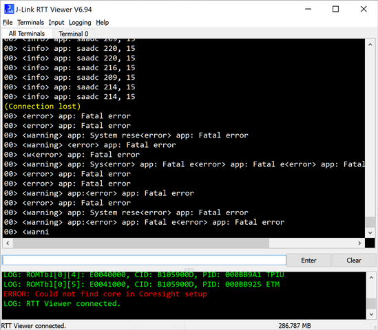

  • Since the "Windows size" and "interval" is a index number and the real time is about "1.25" proportional to the number, so I guess we should correct the MIN_CONN_INTERVAL and MAX_CONN_INTERVAL in the peripheral. Am I right? But when I decreased the parameters to 5 and 35 respectively, The peripheral will keep in fatal errors. How to correct that? Thanks.
  • If you build with DEBUG then you should get more information about the error from app_error_fault_handler() in app_error_weak.c
