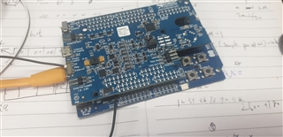

I'm evaluating BLE power consumption with a PCA10040 nRF52DK and a PPK, I cut SB9 and did nothing else with DK.
No peripheral is used in projects, Buttons or LEDs, but I got 18uA idle current after 1minute. Before which idle current is above 200uA, but anyway it exceeded the value written on specification.
Could I have any suggestion how to measure the current with nRF52DK and PPK?
Also I will use an Agilent 66319 power analyzer for formal measurement, but nothing was mentioned in nRF52 handbook. Please also help on it, thanks a lot.

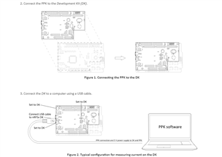

    Are you using PPK1 or PPK2? In ampere meter mode or SMU mode?

    If you want to power the nRF52 DK from a SMU (source measure unit, i.e. advanced power supply, which provides stable voltage and measures the current through the power supply.) you will have to power the + wire on the current measurement header, P22, and the - wire on one of the GND connections. And, set the output voltage to match the DK voltage exactly. It should be around 2.7V. Also, leave the USB cable plugged in to power the rest of the board.

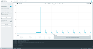

  • Hi, while testing with PPK, ble_app_pwr_profiling has great current and unknown behavior(without press any button now).  Minimum current is about 160 uA.
    I just connect PPK and DK together with SB9 cut. Softdevice version 7.2.0, SDK version 17.0.2
