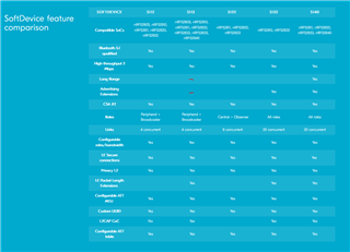

  • Hi Gerard,
    1. Most peripheral applications will be fine with the smaller s113 Softdevice. It's only if your application requires support for either "BT Long range" or "Advertising extensions", then you will need to select the s140 as those features aren't included in the s113 (is part of the memory optimization to remove those features).
    Here is table showing what features are supported for our different Softevice variants:
    (https://www.nordicsemi.com/Products/Bluetooth-Low-Energy/nRF5-SDK-and-SoftDevice)
