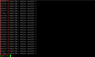

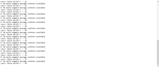

Issue with vendor model sending messages on the nrf connect sdk sample "chat", error "E: No multi-segment message contexts available", the attached file are the screen shot and c code files.
I tried running the "chat" example on two NRF52833DK boards, one as a sender sending a "Hello World" message every 500 milliseconds, the other as a receiver, and found that the board sending the message got a "log" error message. And the receiver can receive a message in about 1.7 seconds. How can I increase the speed at which the vendor model sends messages?
The nRF Connect SDK Version is: v1.5.1

	shell_print(chat_shell, "%d: <0x%04X>: %s",time_counter, ctx->addr, msg);

	err = bt_mesh_chat_cli_message_send(&chat, argv[1]);
	if (err) {
		LOG_WRN("Failed to send message: %d", err);
	/* Print own messages in the chat. */

static void msg_loop(struct k_work *work)
    int err;
    time_counter++;
    err = k_delayed_work_submit((struct k_delayed_work *)work, K_MSEC(1));
    if (err) {
        LOG_ERR("Cannot add work to workqueue");
SHELL_STATIC_SUBCMD_SET_CREATE(presence_cmds,
	SHELL_CMD_ARG(set, NULL,
		      "Set presence of the current client <presence: available, away, dnd or inactive>",
		      cmd_presence_set, 2, 0),
	SHELL_CMD_ARG(get, NULL,
		      "Get presence status of the remote node <node>",
		      cmd_presence_get, 2, 0),
	SHELL_SUBCMD_SET_END
static int cmd_presence(const struct shell *shell, size_t argc, char *argv[])
	if (argc == 1) {
		shell_help(shell);
		/* shell returns 1 when help is printed */
		return 1;
	if (argc != 3) {
		return -EINVAL;
	return 0;
SHELL_STATIC_SUBCMD_SET_CREATE(chat_cmds,
	SHELL_CMD_ARG(status, NULL, "Print client status", cmd_status, 1, 0),
	SHELL_CMD(presence, &presence_cmds, "Presence commands", cmd_presence),
	SHELL_CMD_ARG(private, NULL,
		      "Send a private text message to a client <node> <message>",
		      cmd_private_message, 3, 0),
	SHELL_CMD_ARG(msg, NULL, "Send a text message to the chat <message>",
		      cmd_message, 2, 0),
static int cmd_chat(const struct shell *shell, size_t argc, char **argv)
	if (argc == 1) {
		shell_help(shell);
		return 1;
	shell_error(shell, "%s unknown parameter: %s", argv[0], argv[1]);
	return -EINVAL;
SHELL_CMD_ARG_REGISTER(chat, &chat_cmds, "Bluetooth Mesh Chat Client commands",
		       cmd_chat, 1, 1);
/******************************** Public API **********************************/
const struct bt_mesh_comp *model_handler_init(void)
	k_delayed_work_init(&attention_blink_work, attention_blink);
	chat_shell = shell_backend_uart_get_ptr();
	shell_print(chat_shell, ">>> Bluetooth Mesh Chat sample <<<");
        k_delayed_work_init(&msg_loop_work, msg_loop);
        int err;
        err = k_delayed_work_submit(&msg_loop_work, K_MSEC(1));
        if (err) {
	return &comp;
    int err;
    char *msg = "hello world!!!";
    static uint32_t counter = 0;
    err = bt_mesh_chat_cli_message_send(&chat, msg);
    if (err) {
    printk("<you>: %s -- %d\n", msg, counter++);
    err = k_delayed_work_submit((struct k_delayed_work *)work, K_MSEC(500));
    if (err) {
