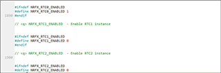

I am using nRF52833 device in my project along with nRF5_SDK_for_Thread_and Zigbee_v4.1.0_32ce5f8 SDK. There is RTC0 enabled and RTC1 and RTC2 disabled at present (somewhere in code it is mentioned RTC0 for soft device and RTC1 for app_timer.c library so trying to invoke RTC1).

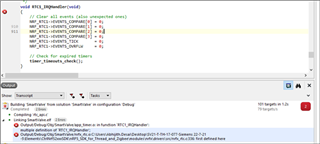

Now, I tried to enable RTC1(present in sdk_config.c) but it throws error
And also I can see that there are no handlers for RTC0 and also for RTC 2, and if I comment this RTC1_IRQHandler function part the project builds.
  • Where is this function linking to?
  • It is not been called anywhere in the entire project
  • Is that function not actually required?
  • Or it is referring to some other library file?
I tried to do something that is mentioned in this link but that doesn’t help(RTC1 handler issue) - https://devzone.nordicsemi.com/f/nordic-q-a/54713/beacon-and-rtc-combination-errors

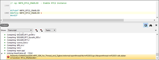

And related to RTC 2:
I saw in some development zone link that says things worked with RTC2 well when compared to RTC1.
If I try to enable RTC2 I get this error. And it is again related to RTC2_IRQHandler in alarm.c.
    RTC1 is used in app_timer library as you mention. To prevent it from being compiled/linked you need to remove the source file (app_timer.c) from the project, or disable app_timer in your sdk_config.h file:
    // <e> APP_TIMER_ENABLED - app_timer - Application timer functionality
    #ifndef APP_TIMER_ENABLED
    #define APP_TIMER_ENABLED 0
    Note that app_timer may be used by other library modules in your application/example, but then you will get undefined reference errors when trying to remove it.
    As mentioned in Thread nRF52840 peripheral requirements, RTC2 is used by the OpenThread stack.
    Are you running a multiprotocol application with Softdevice? If not, RTC0 can safely be used by application.

  • Hi, thanks for you time on this..
    I am able to disable RTC0 - which is not required for the current code.
    RTC1 is running for app_timer (all timer functions are controlled)
    RTC2 - is used for thread stack.
    Note: Disabling or enabling in sdk_config.h doesnt make any difference, if thread stack is used then RTC2 is enabled(possibly to be disabled in sdk_config.h).similarly, if RTC1 is used for app_timer library.
