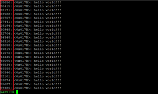

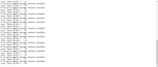

Issue with vendor model sending messages on the nrf connect sdk sample "chat", error "E: No multi-segment message contexts available", the attached file are the screen shot and c code files.
I tried running the "chat" example on two NRF52833DK boards, one as a sender sending a "Hello World" message every 500 milliseconds, the other as a receiver, and found that the board sending the message got a "E: No multi-segment message contexts available" error message. And the receiver can receive a message in about 1.7 seconds. How can I increase the speed at which the vendor model sends messages?
The nRF Connect SDK Version is: v1.5.1
