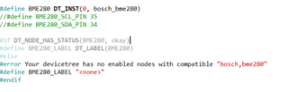

#define BME280 DT_INST(0, bosch_bme280)
#if DT_NODE_HAS_STATUS(BME280, okay)
#define BME280_LABEL DT_LABEL(BME280)
#else
#error Your devicetree has no enabled nodes with compatible "bosch,bme280"
#define BME280_LABEL "<none>"

  • i just tried to create another project but from another directory this time
    i think i broke something in the processing operation
    but the thing is that in my project BME280
    the DT_NODE_HAS_STATUS function became grey
    and the other one appeared
    so i think even by correcting this error
    i will get the classic error of "devicetree has no enabled nodes"
    i don't know what to do actually, i tried alot of methods but the error doesn't go
    do you recommend some team members that can help me
    i'm really stuck and it's getting complicated
